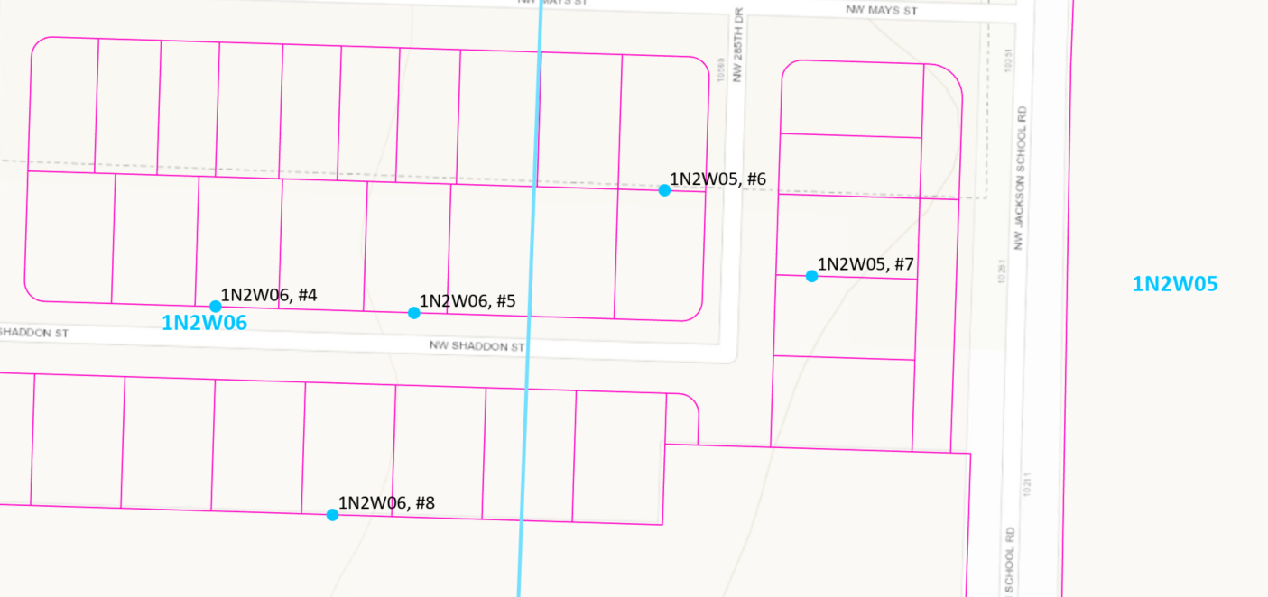

This works well for numbering all the features but what I need is sequential numbering by tile name. In the example below I'd like all the number on the left to be 4, 5, 6 and the numbers on the be 1 and 2. Thanks for your help!

Thanks for the reply. Let's see if I can give you a better explanation.
Let's say I have two polygone (A,B) and a point feature class (Dedications). The Dedications feature class has two fields. "TILE_NAME" and "ID."
I want to add 3 dedication points to polygon A. When I add the first point the rule will append 'A' from the polygon to the the Dedications "TILE_NAME" Field and create a sequential number, in this case "1" to the the ID field. When I add points two and three "A" is applied to both points "TILE_NAME" fields, but the next sequential numbers are "2" and "3."
Now I want to add a point to B. B is appended to "TILE_NAME" but "1" is created for the "ID" field. Then if I create another point in polygon A, the next ID would be "4."
I hope this helps.

JwHayes
Rhett,
That pretty much did the trick - thank you! 😁
I did make a couple adjustments (lines 20,21 and 27). Added  IsEmpty to assign a value of 1 if NULL, and converted newID value to integer to match my field type. Oh, and changed "TITLE_NAME" to "TILE_NAME."  🙂
