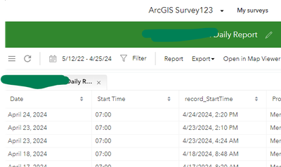

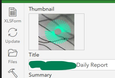

3.18 changed the name of survey, and the data is in AGOL, but ArcPro can't see the main table data
1112
5
04-25-2024 01:20 PM
MichelleWilliamsERM
MichelleWilliamsERM_1-1714076324711.png AGOL reflects NEW name
MichelleWilliamsERM_0-1714076286998.png ArcGIS Pro reflects OLD name
How do I get them to sync up?
I removed and re added the hosted service to ArcGIS Pro.
MichelleWilliamsERM
WE fixed it, I made a new aprx, and downloaded the hosted service.
The hosted service in the original aprx. must have gotten corrupt.

I moved this to the ArcPro Comunity since this appears to be related to ArcPro behaviour. But I wonder if both are not correct in this case.
You created the service with the "old" name, but then updated that name in another application. That updated name is likely just an alias and ArcPro is simply displaying the true name of the item (i.e., the "old name"). If that is the case, then I don't believe there is much you can do.

Here's a little more context. I changed the name of the survey itself. Which changed the name of the main layer in AGOL.
ArcGIS Pro downloaded the hosted service with the old main survey name.

Ah, okay. Then it is what I described then. That field is an alias field. It updates the name in several spots that are visible to those both taking and working with S123 items, but it does not change the true name of the item. Whatever you first create/publish an item as is its true name.
I try and lecture people on this for SharePoint items and lists all the time. Give something its long-term permanent name first, then you can give it a human-friendly name. Generally speaking, the only thing in SharePoint most people will notice this though is the URL.
