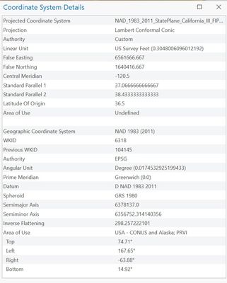

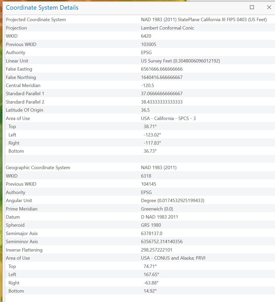

I am running the Project Raster tool on a DEM and choosing a listed state plane coordinate system I've used hundreds of times: Projected Coordinate System NAD 1983 (2011) StatePlane California III FIPS 0403 (US Feet) | WKID: 6420 | Authority: EPSG

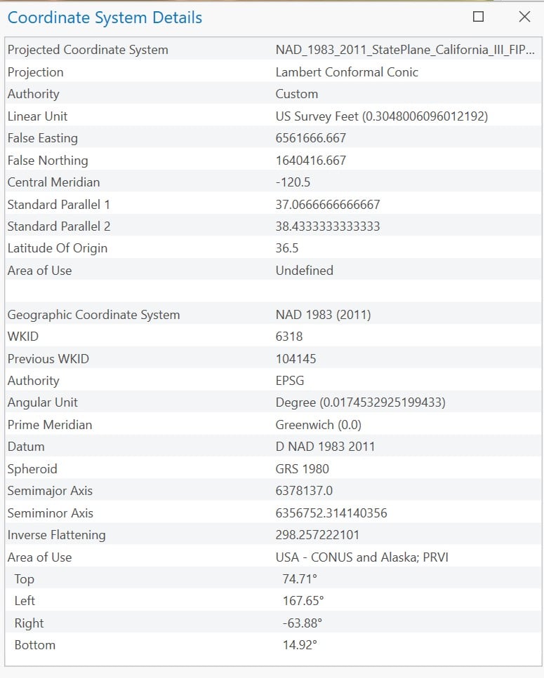

When the Project Raster tool is finished, I check my DEM and it does not have the same exact coordinate system details. Under properties, the coordinate system details of the DEM does not give a WKID and the authority changes to custom. I see this all the time when I get spatial data from other applications but this has NEVER happened after I run the project tool and choose a listed CRS. It's important for me to be able to assign data the listed coordinate system that I mentioned in the above paragraph. I think it's very strange that after running the project tool, and telling Pro to use that coordinate system, that the data still does not contain the right CRS properties.
I should mention that I have downloaded esri's add-on ArcGIS Coordinate Systems Data so that I can conduct vertical datum transformations. Maybe I need to re-download this after every Pro update? Or maybe this is just a weird bug with Pro? Please let me know if anyone has any ideas or insight on this problem.
First image shows the details of the listed CRS I am trying to apply to the DEM. The second image shows the DEM's CRS details after running the project tool. Notice there is no WKID and authority is unknown.

I am having the same issue ever since updating to ArcGIS Pro 3.2.2.
Pro is no longer recognizing the projected coordinate systems of orthomosaic rasters that I used to create maps in the previous version before updating.

I have the same issue. I think it's an issue with how projections are being applied to raster files. If I use another software (GDAL, rasterio, etc) to define the projection using EPSG code, ArcGIS Pro will recognize it. It just can't "give" it...
