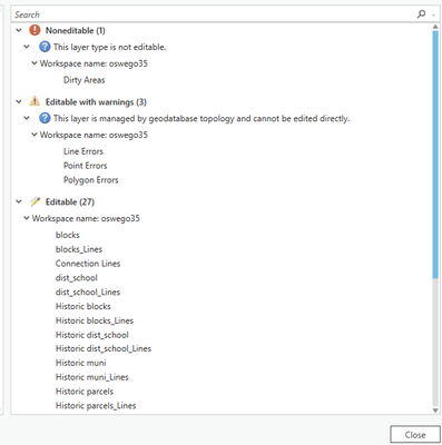

Hey All - I've been editing our tax parcels in Pro (version 2.7 now) with parcel fabric for about 3 months now and one of my favorite workflow improvements has been the ability to just click and move points to make small adjustments to my parcels. It worked great in the beginning, then it started showing this error every now and again when I tried to move a point:
No worries, because I would just close out of Pro, reopen my project, and it would work again. I figured it was a problem with a lock file on one of the fabric layers or something. A few days ago though it started popping up with that message every time I tried moving a point and my old trick or restarting Pro doesn't work anymore.

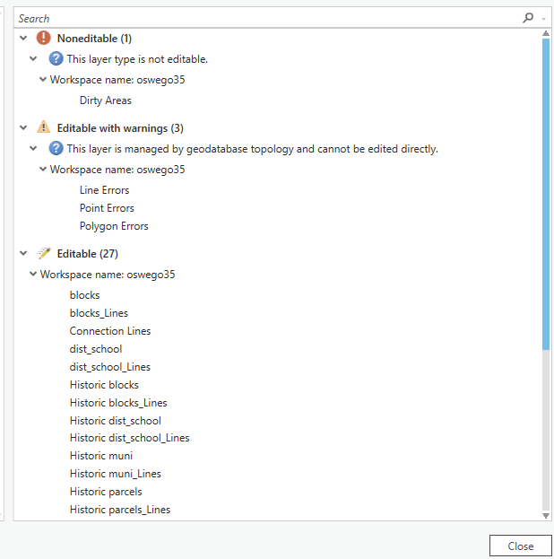

Everything is checked for editing and the Status dialog doesn't point out anything obvious to me either:
I'm also working in just a file geodatabase so I can't imagine there's any other permission issues occurring. Has anyone else encountered something like this?

Solved.
My project (.aprx) file ended up being the problem. I tend to keep my project open with multiple tabs since I have 2 different layout and 2 editing maps (one with the topology and one with non-topology layers and my annotations). However, opening the fabric in a brand new project allowed the points to be moved and the topology to update as intended with the fabric.
So in my original project I was able to "reset" it by:
  1. Closing ALL tabs/views except Catalog
  2. Saving the project and closing Arcgis Pro
  3. Re-opening Pro
  4. Opening only the map that contains the fabric
I'm now able to edit points again. My working theory is that one of my layouts contains the map that has my fabric topology in it and "activating" the map in that layout may be conflicting with editing the map itself elsewhere in my project.

We encounter this kind of error all the time and I think it has to do with having project files with layer configurations that grow stagnant because the maps/project files were created in earlier releases.
Our solution when this "Layer is not editable" error occurs is to add your parcel fabric freshly to a brand new map.  You an either edit the parcel fabric out of that new map, or, if you don't want to abandon your map where the error is returning because you like the customizing you have done with your table of contents (layer colors, labeling configurations, etc) - take the topology layer from the freshly-added map and use it to replace the topology layer in the map giving you the problems by way of copy/paste delete.  Save and re-open the project file, and the error should not occur when you attempt to move parcel fabric points.
I can't speak for ESRI but it seems like when there are Pro version updates, there are some very subtle configurations that update to certain layers behind the scenes and .aprx files that have been in-use for editing for long periods of time fall victim to these kind of errors when some of the most important layers kind of need a reboot by way of adding the fabric from the controller object in Catalog to a new map.
