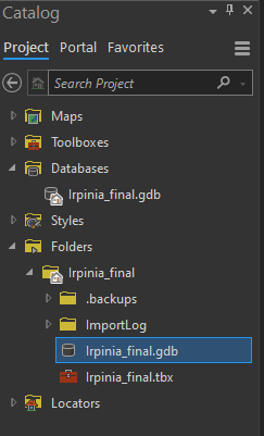

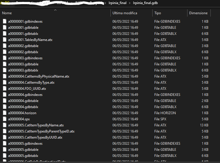

I have an issue with the database. When I try to open it from ArcGis it seems empty (1st image) but there is stuff inside (2nd image). I can't understand why this is happening, any ideas why and/or any ideas on how to solve this problem?

By default, AGP creates a unique Home (the house icon) file geodatabase automatically for each Project when it's first created using the same name as the Project. It also creates a unique folder, toolbox and a few other things for a new Project by default. A file geodatabase appears as a folder to File Explorer and contains about 41 small files when first created. It is however viewed as empty by AGP until feature classes, etc., get added to it.
