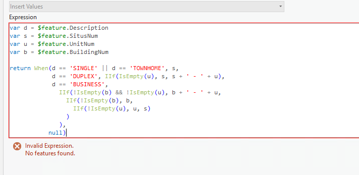

So I get the below error when trying to update on my end. It is a direct copy and paste, all I did was keep the '$feature.' in front of each variable.
KenBuja
MVP Esteemed Contributor
Hmmm...I tested a version of this in Pro using my data and it performed as expected.
What happens if you start by adding one When condition at a time?
