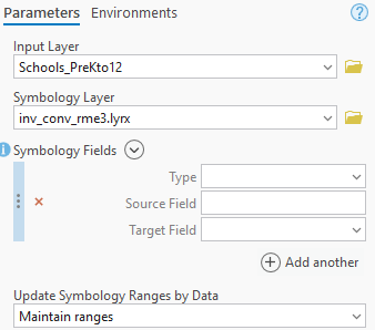

Hi All,
I am having an issue with the "Apply Symbology from Layer" tool. I have been creating symbology for two "Big Integer" fields and have no issue creating and exporting the symbology as a layer file, but when it comes to testing the layer file and importing it, it no longer recognizes the big integer fields. I have had no problem with other data types, just this one in particular. I think it might be a bug as almost all my problems come from the big integer type. 😇
Any help would be greatly appreciated!

Workaround - when adding the symbology, hit the remove button (red x) and then run the tool, it will work without issue.
