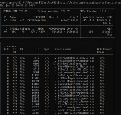

When I run the toolbox "Classify pixels using deep learning" with the CPU, everything seems fine, except that it runs extremely slow. So I tried to run it with the GPU and got multiple failures::
ExecuteError: ERROR 999999: Something unexpected caused the tool to fail. Contact Esri Technical Support (http://esriurl.com/support) to Report a Bug, and refer to the error help for potential solutions or workarounds.
Parallel processing job timed out [Failed to generate table]
Failed to execute (DetectObjectsUsingDeepLearning).

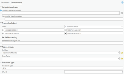

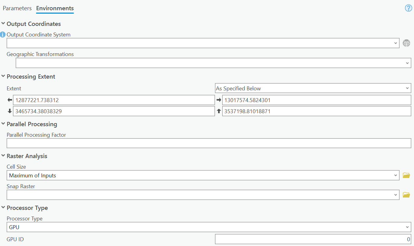

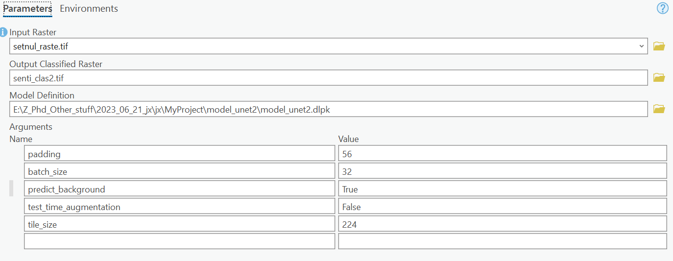

The parameters and environments were set as below:
Then I further try it in the Python command line with:
with arcpy.EnvManager(processorType="GPU"):
out_classified_raster = arcpy.ia.ClassifyPixelsUsingDeepLearning("setnul_raste", r"E:\Z_Phd_Other_stuff\2023_06_21_jx\jx\MyProject\model_unet2\model_unet2.dlpk", "padding 0;batch_size 32;predict_background False;test_time_augmentation False;tile_size 224", "PROCESS_AS_MOSAICKED_IMAGE", None); out_classified_raster.save(r"E:\Z_Phd_Other_stuff\2023_06_21_jx\jx\MyProject\MyProject.gdb\setnul_raste_ClassifyPixelsU3")
The same error occurred:
File "<string>", line 2, in <module>
File "C:\Program Files\ArcGIS\Pro\Resources\ArcPy\arcpy\ia\Functions.py", line 2206, in DetectObjectsUsingDeepLearning
return Wrapper(
File "C:\Program Files\ArcGIS\Pro\Resources\ArcPy\arcpy\sa\Utils.py", line 55, in swapper
result = wrapper(*args, **kwargs)
File "C:\Program Files\ArcGIS\Pro\Resources\ArcPy\arcpy\ia\Functions.py", line 2195, in Wrapper
result = arcpy.gp.DetectObjectsUsingDeepLearning_ia(
File "C:\Program Files\ArcGIS\Pro\Resources\ArcPy\arcpy\geoprocessing\_base.py", line 512, in <lambda>
return lambda *args: val(*gp_fixargs(args, True))
arcgisscripting.ExecuteError: ERROR 999999: Something unexpected caused the tool to fail. Contact Esri Technical Support (http://esriurl.com/support) to Report a Bug, and refer to the error help for potential solutions or workarounds.

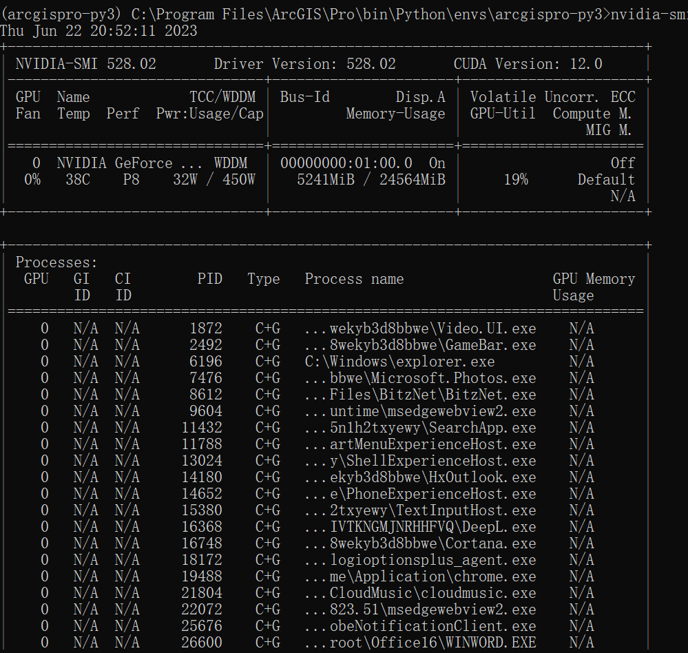

My PC has an AMD 7950X CPU and RTX 4090 (GPU0) and the version of ArcGIS Pro is 3.0.1. Is there any solution or suggestion?
