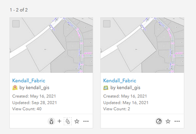

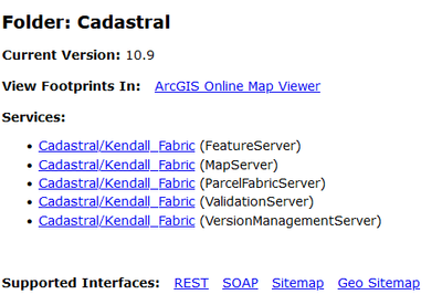

The feature service and map image service do indeed have different sharing settings in the portal.
I had assumed that restricting the sharing settings on the feature service would simply hide that URL from users not in the groups shared with. However, in the situation shown above, I was able to see all services in the REST directory as an anonymous user.
Even more troubling was that as an anonymous user, the query and edit capabilities were also available to me, and worked without issue.
I have seen the reverse of this problem as well, when a user who had access to the feature service, but not the map image layer, was unable to access the feature service at all.
This feels a bit like a bug to me. For now, I think the safest option is to publish the map image layer separately from your feature service to guarantee that unauthorized users cannot touch the data.
