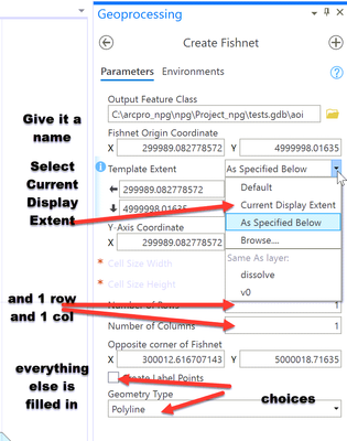

DanPatterson
MVP Esteemed Contributor
Using tools in ArcToolbox
Create Fishnet (Data Management)—ArcGIS Pro | Documentation

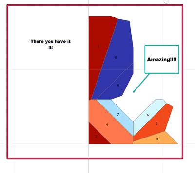

DanPatterson
... sort of retired...
SterlingL
Dan this works great as well! Thank you.
