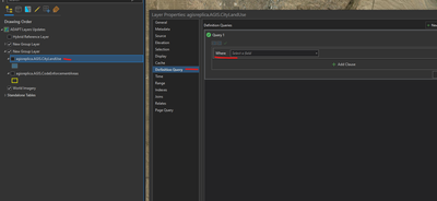

If you only want to show one of the towns you will need to make a definition query on that layer as in the screen shot below. Right click on your layer in the table of contents then pick definition query and build a query that is for the town name:
