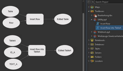

As Dan said, there's no out of the box tool. If you need that functionality in Model Builder, you have to create that tool yourself.
Below are two quick examples. You can save that script as a Python toolbox (.pyt), load that into ArcGIS Pro, and then drag the tools in to your model.

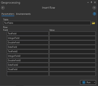

class InsertRow(object):
    label="Insert Row"
    description="Inserts a row into a table"
    def getParameterInfo(self):
        parameters = [
            arcpy.Parameter(name="in_table", displayName="Table", datatype="DETable", parameterType="Required", direction="Input"),
            arcpy.Parameter(name="row", displayName="Row", datatype="GPValueTable", parameterType="Required", direction="Input"),
            arcpy.Parameter(name="out_table", displayName="Edited Table", datatype="DETable", parameterType="Derived", direction="Output"),
        parameters[1].columns = [
            ["GPString", "Field"],
            ["GPString", "Value"]
        return parameters
    def updateParameters(self, parameters):
        par = {p.name: p for p in parameters}
        in_table = str(par["in_table"].value)
        # reset fields if no table is selected
        if in_table == "None":
            par["row"].value = None
            return
        # get fields from the table
        target_fields = [
            f.name
            for f in arcpy.ListFields(in_table)
            if f.type not in ("OID", "GlobalID", "Geometry")
        # get currently loaded fields
        current_fields = []
        if par["row"].value is not None:
            current_fields = [
                f
                for f, v in par["row"].value
        # if these don't match, a different table was selected -> change fields
        if current_fields != target_fields:
            par["row"].value = [[f, None] for f in target_fields]
    def execute(self, parameters, messages):
        # get fields with user input
        row = [
            [field, value]
            for field, value in par["row"].value
            if value not in ('', None)
        fields, values = list(zip(*row))
        # insert the new row
        # all values are str, but the InsertCursor should take care of the conversion
        with arcpy.da.InsertCursor(str(par["in_table"].value), fields) as cursor:
            cursor.insertRow(values)
        # set the output parameter
        par["out_table"].value = par["in_table"].value

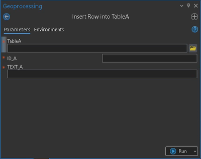

class InsertRowIntoTableA(object):
    label="Insert Row into TableA"
    description="Inserts a row into TableA"
        parameters = [
            arcpy.Parameter(name="in_table", displayName="TableA", datatype="DETable", parameterType="Required", direction="Input"),
            arcpy.Parameter(name="ID_A", displayName="ID_A", datatype="GPLong", parameterType="Required", direction="Input"),
            arcpy.Parameter(name="TEXT_A", displayName="TEXT_A", datatype="GPString", parameterType="Required", direction="Input"),
            arcpy.Parameter(name="out_table", displayName="Edited TableA", datatype="DETable", parameterType="Derived", direction="Output"),
        return parameters
        # get the values
        fields = ["ID_A", "TEXT_A"]
        values = [
            par[f].value
            for f in fields
