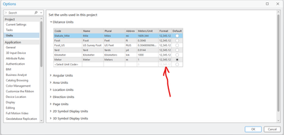

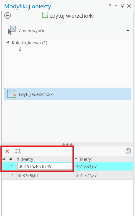

Is it possible in ArcGIS Pro to limit the display of coordinates to 2 decimal places, or to set the coordinate display precision globally?

Danielb3
Is it possible in ArcGIS Pro to limit the display of coordinates to 2 decimal places, or to set the coordinate display precision globally?Zrzut ekranu 2025-05-23 234806.png
HansRasmussen
Maybe here....
BrendanNewell
hi @Danielb3 follow the above screen shot but navigate to "location units" and click on the format column to change the number of decimal places. this will change it in the edit vertices tool.
