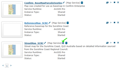

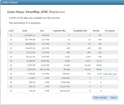

SCCGIS
You can do this in ArcGIS Server Manager
