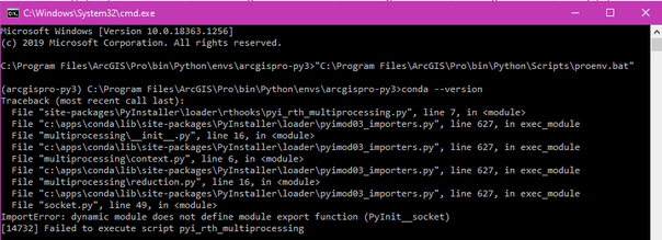

MarcSwartz
First off, Dan thanks for responding!
Current Environment
In a command window I ran this
C:\Program Files\ArcGIS\Pro\bin\Python\envs\arcgispro-py3>"C:\Program Files\ArcGIS\Pro\bin\Python\Scripts\proenv.bat"
then tested with conda --version
issue persists
Of note:  When I run under an Admin account I do not have this problem, but it is against out IT policy to operate software under an Admin account.  And the Clone I create under an Admin Account is not accessible as a General user (local account?)
