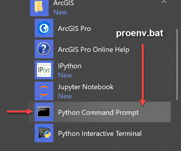

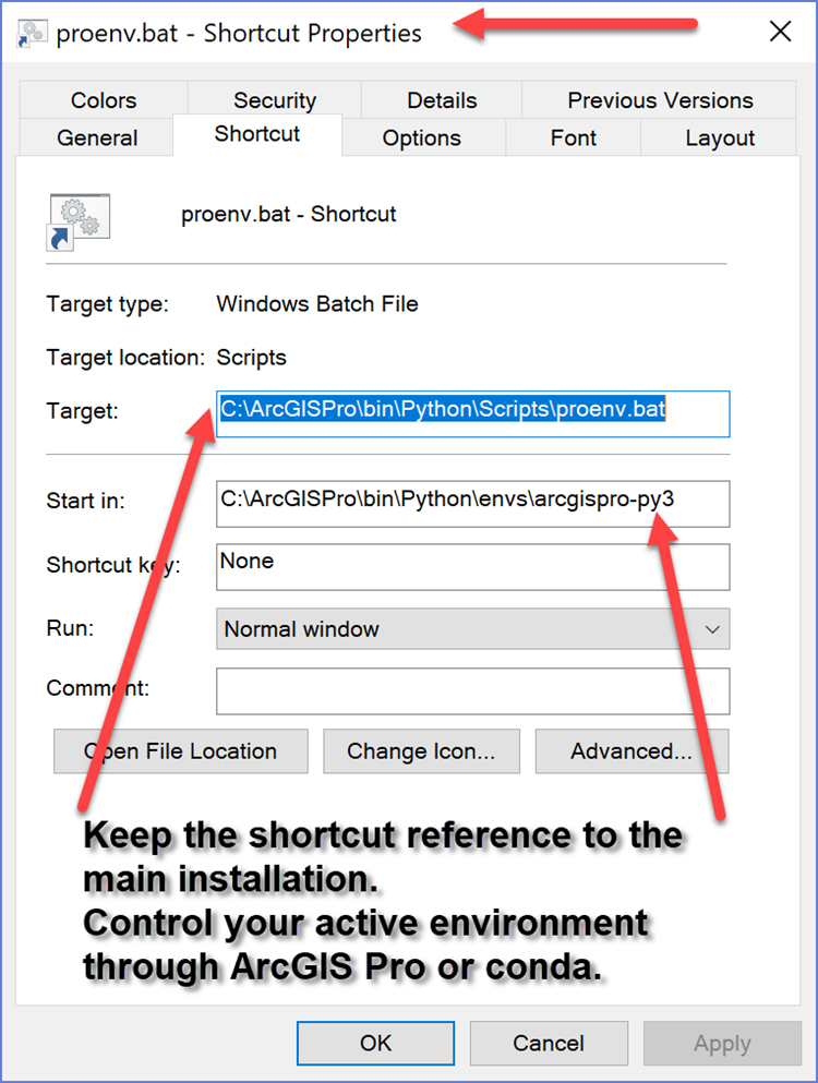

Access proenv.bat
You can launch proenv.bat via your windows start options under the guise of the Python Command Prompt.

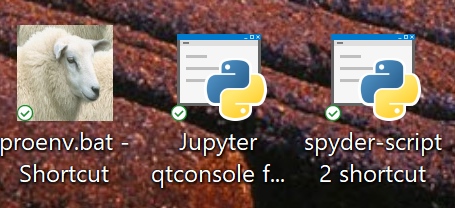

I prefer to make a desktop shortcut as shown below.
Your environments can be controlled within ArcGIS Pro's package manager or via 'conda' accessed through proenv.bat.

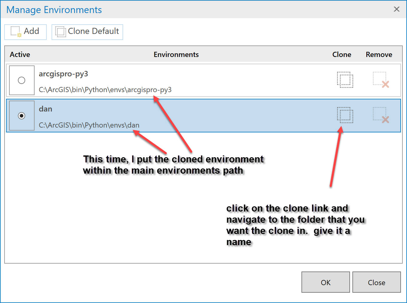

Cloning from within Pro
It is slower and you don't get a lot of information, but they are improving it as they go along.  Activate the environment, close Pro, then restart with the new environment.

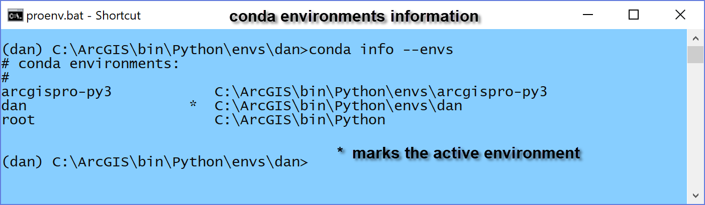

The shortcut brings up the command prompt in you active environment.  To obtain information on your environments, just run conda info --envs

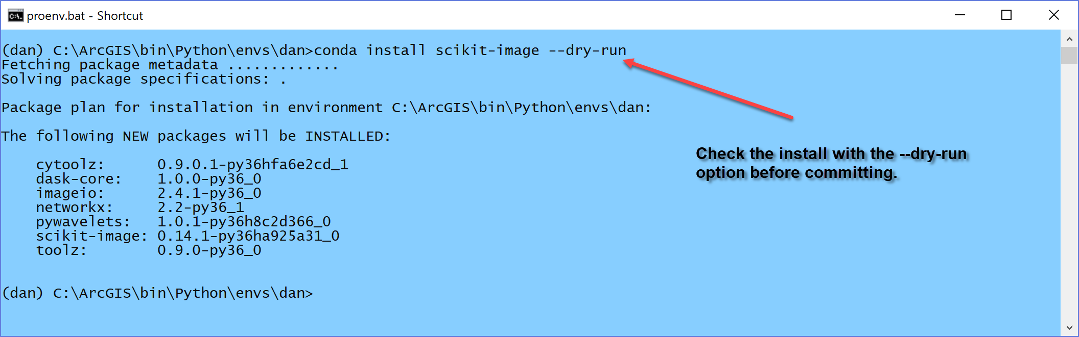

You can add a package from within the package manager of via conda.  Since I prefer the --dry-run option in conda, I will illustrate it here.  You can leave out the --dry-run option to perform the actual install once you are sure you won't cause any foreseen issues.

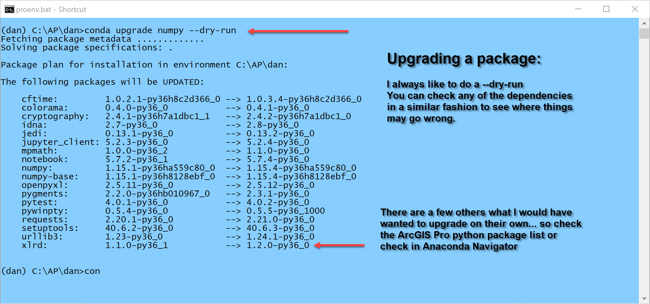

You can upgrade a package either from the package manager in ArcGIS Pro or via conda.  The package manager seems to take longer and you don't get much feedback during the process.
Again, I prefer to examine an upgrade using the --dry-run option first, prior to committing.

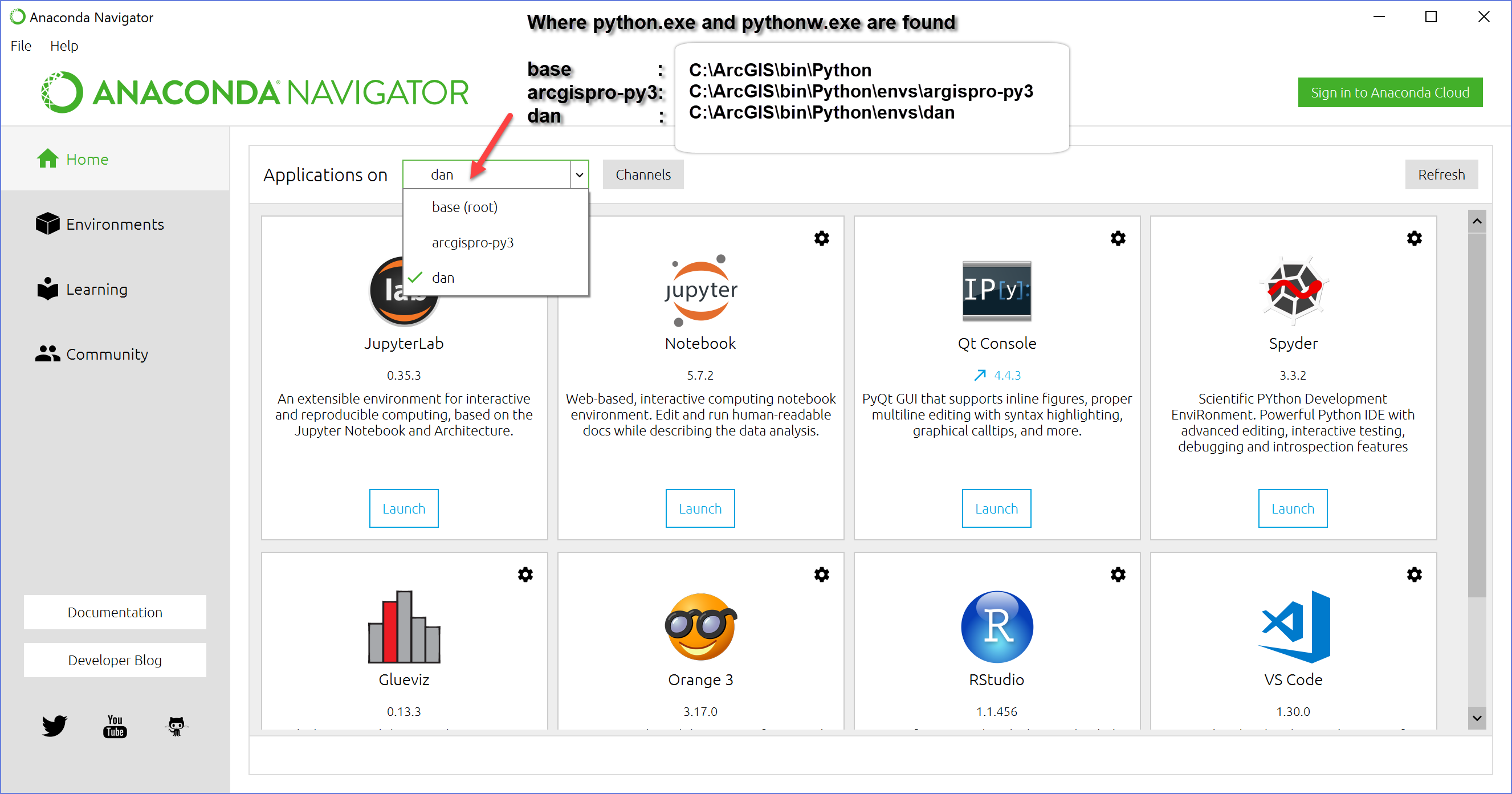

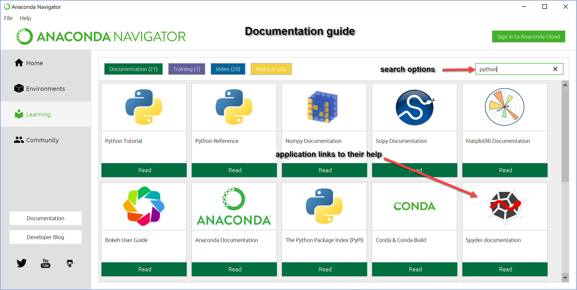

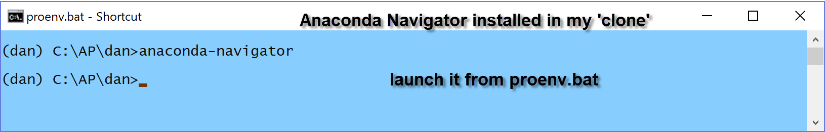

Anaconda Navigator
Now not everyone needs this nor can everyone do this, but with a patch on a single file, you can add an alternate package manager and access to a load of documentation links.
application launcher
documentation links
the catch

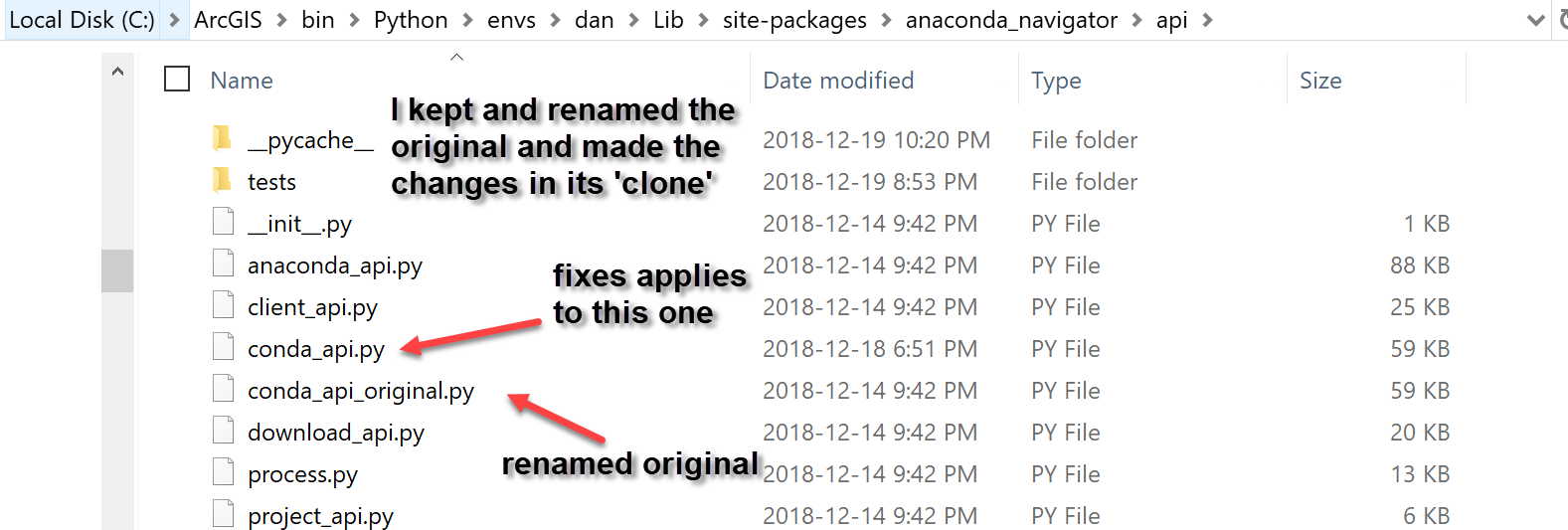

In order to get the above, you have to edit a few lines in the 'conda_api.py' which will located in your clone path
C:\ArcGIS\bin\Python\envs\dan\Lib\site-packages\anaconda_navigator\api
The patch given by
Patch Anaconda Navigator to use conda executable instead of root python wrapper to conda · GitHub
entails altering a couple of lines in the conda-api.py file.  I made a copy of the original and made fixes to the other in case I needed to undo the changes quickly.  Not ideal, but worth it if you need to provided documentation and application shortcuts to users with diverse computing backgrounds.
