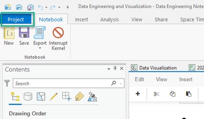

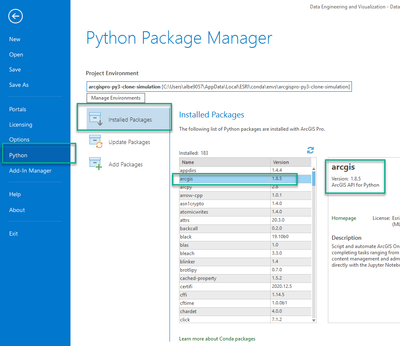

(to check, select the "Project" menu at the top-left corner of ArcGIS Pro...
... then check the Python option, select Installed Packages, then select arcgis:

- What version of the ArcGIS API for Python do you have installed in ArcGIS Pro?
1.8.5
