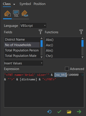

Here is an option in VBScript (also works in ArcGIS Pro > Layer Labeling Properties)
How To: Include table fields in a VBScript label expression and use those values as dynamic font pro...
Unlike the example in the above link, I didn't create new fields for the purpose, but did the calculation in the expression itself.
In the above example, 100000 is the factor divided by which my value field would result in values ranging from 6 to 18 (approx.). You could choose the factor that gives you the desired range of proportionate values.

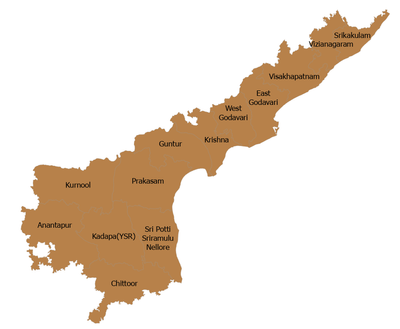

Before Custom Expression

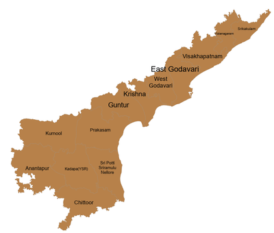

After custom expression
