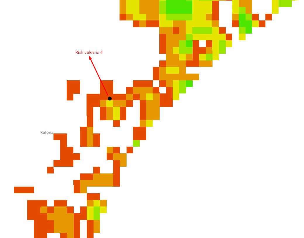

Hi everyone,
I have a raster file with 5 different values (1-5) for the pixels. 1 to 5 represent the risk level. Also, I have points that describe the location of sites. I'm looking for the best tool to find the intersection of pixels and points to add risk level to the points attribute table. Please take a look at the attached file.
Thanks all for the help.
Cheers
Enes

Extract by Points (Spatial Analyst)—ArcGIS Pro | Documentation
amongst other options
