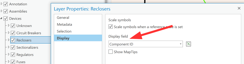

Can someone point me to where the getter/accessor is for the display field on a layer?
This is a layer in a group subtype layer aka "preset layer" in Pro if that makes a difference.
Display Field - where is it?Display Field - where is it?

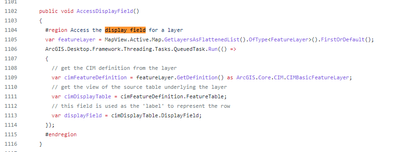

I stole this from github.  It might help you a little.
KimberlyGarbade
BillBott
Thank you! I'll give that a whirl.
