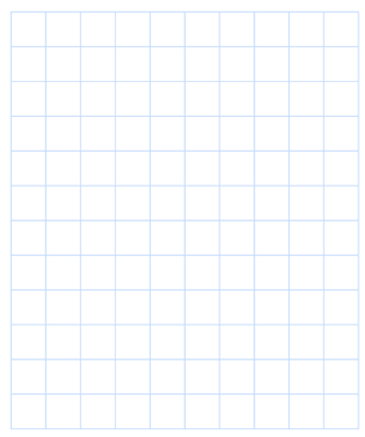

Input Line Fishnet

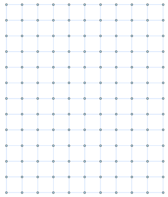

Input Line Fishnet with Intersect Points
