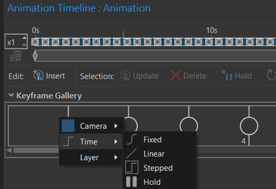

All of the documentation I've read so far focuses on how you can fine-tune the camera's behavior, but for my purposes I don't want the camera to move; the only frame-to-frame changes are the heatmap's time intervals. I know the user is able to change the keyframe transition behavior specifically for time:
... and mine is set to 'Stepped' by default, but every time I've tried switching it to either fixed or linear and refreshing my animation timeline, the whole thing becomes stuck on one single time stamp.
If I want something smoother like cross-fades between time series key frames, is my only option for now to export each key frame as a static image and then use a different piece of video software to string them all together?
