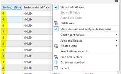

This is an area where it does not appear like the ArcGIS Platform plays by the same rules.  For example, in Collector and Field Maps, the user is able to see a domain drop down list that displays the Description value.  This is true for Text or Integer domains.
When it comes to ArcGIS Pro, fields with Integer domains display only the code while editing as well as in the attribute table. This behavior is different from a Text domain where the user only sees Description while editing as well as viewing the attribute table.

Turns out this is not consistent between other features in the database. The common thread I can see is that the features where the domain does not properly display are on features that use a Subtype.  If a feature does not have a Subtype, it works just as you and @KenBuja noted in your screenshots.
I assume this is a bug and will contact ESRI Support.

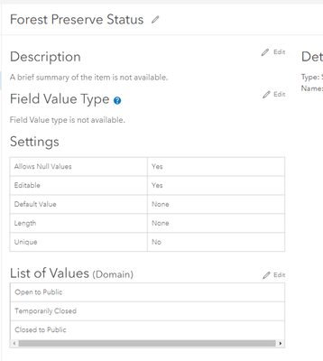

I would go into the Data Design → Fields view in Pro, or the Data → Fields page in your portal, to make sure that there is actually a domain in place.

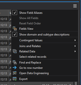

If there is truly a domain there, just double-check whether the setting Show domain and subtype descriptions is checked or not in the Attribute Table.

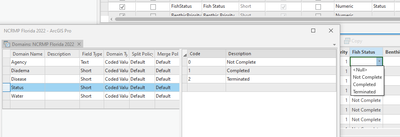

Unless I'm missing something, I don't see that in my project. I have integer fields that use a domain and I see the description, not the code when I edit them.

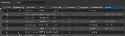

Thanks @jcarlson and @KenBuja  this is not my experience. Here are some screenshots of what I see on 2.8.3.

And you've confirmed that the domain actually exists in the Fields view?

Is that different from my first screenshot of the last post?  Also here is the domain to confirm the values

There were a couple things that helped resolve the issue.
1)  Make sure that each subtype has the domain assigned to the field. There were some instances where we had a subtype that had default settings for the fields and were missing the association of a domain. With the field being an integer, only numbers were showing until we associated that field in that subtype with a domain
2) If you are publishing a service to ArcGIS Server and that feature uses subtypes, I've had to set the cartography on the subtype value as my unique values field association. If I did not do this, the descriptions would not display instead just the codes.
Hope this helps!
