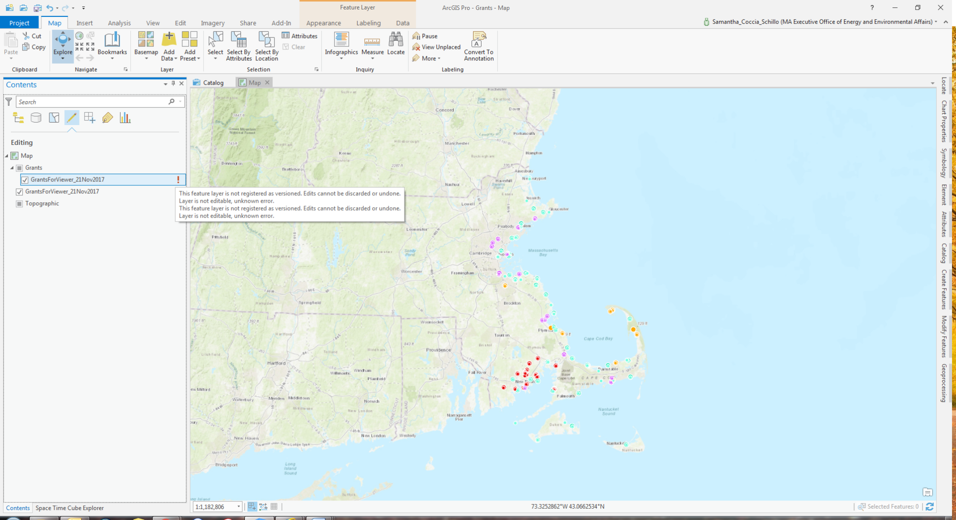

Hello,
I was able to do this once before months ago and I have since had issues editing AGOL data in ArcPro.  I start by adding data to my ArcPro project from My Content in the Portal.  The data I add are all data that I own and shared as a feature service to AGOL.  My data displays in ArcPro, but I am unable to do the live editing on the data that I was once able to do.  See the screenshot below for the error message I receive.  I have been unable to find any help documents that address this.  Have I missed a step perhaps in making this data editable in ArcPro?

Samantha,
Can you check the editing settings for that feature layer on agol. See if you can edit the layer through the online map viewer too.

why do you have two layers the same in the table of contents?
by Anonymous User
Not applicable
I had the original layer (the one saved to my computer) open when I made the screen grab.  It gives me the same error whether or not any other layers are in my map with the AGOL layer.  The layer with the error is the AGOL layer.

Samantha,
by Anonymous User
Not applicable
Thanks Sean, I tried that this morning and now it is working.  It was still giving me that error message even after I turned on editing in AGOL but now it appears to be working and letting me edit in ArcPro.
