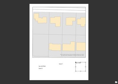

I am trying to insert Dynamic Text using Count statistic. However, when I put the statistic in my map, I get '0' as the value.
 The value is returning '0' when it should return the number of attributes in the table.
How do I fix this?

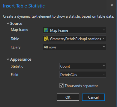

The count statistic will show the number of all rows in the feature class - in this case - all the rows in the feature class.  So if your FC has 100 rows the count dynamic text will show "Gramercy 100".  If you change all rows to "visible rows" the dynamic text will show you a count of features (i.e. row) in the spatial extent.  If you want to sum of an attribute field within your FC, then you would use the SUM dynamic text in the Table Statistics group.
Now if there is a NULL in any of those fields then this will throw a zero as you noticed.  This has been a reported bug.
