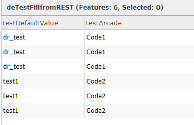

DominicRobergeIADOT
hummm I just tested it here using the following code
var drTest = $feature.testDefaultValue;
var drNewVal = When(
    drTest =='dr_test',"Code1",
    drTest =='test1',"Code2",
    "complete"
return drNewVal;
and that got me this:

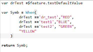

perhaps there is an issue with the formula. Other things to keep in mind.
1) make sure you have all options available when creating the symbology (in my case I don't have records with value 'test2' yet therefore it's not an option when creating the symbology)
2) Otherwise, make sure to select the Other option
it should work. Good luck!
martabescansa7
my bad...i forgot to save the symbology expression, that's why it was dissapearing...
Your solution works both in AGOL and when I edit the map in ArcGIS Pro importing it from AGOL, many many thanks!!
