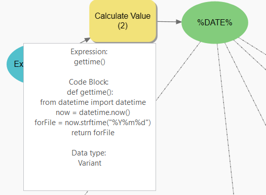

Calculating the date in YYYYMMDD format as the first step in my model for all of my output Feature Classes to have that at the end of their name. I use the Calculate Value tool to get the Variant YYYYMMDD and I am trying to pass it to multiple output FCs throughout the model.
This shows how I calculate the %DATE% variable-

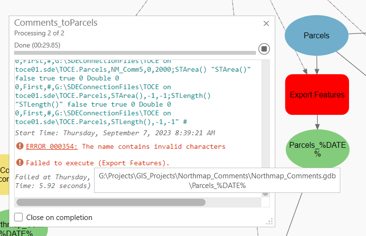

I set the Calculate Value took as the Precondition for the next step, which is here- I try to add the variable sub to an output FC name (Parcels_%DATE%), it tells me that it Contains Invalid Characters-

Your script logic looks sound but its how you are reference the inline variable that is the issue.
Your calculate value tool - don't name its output with 1) a database reserved word and 2) with %% around it. Call it something like myDate.
If you had renamed the output to %bob% then you would need to reference it as %%bob%%.
