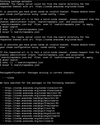

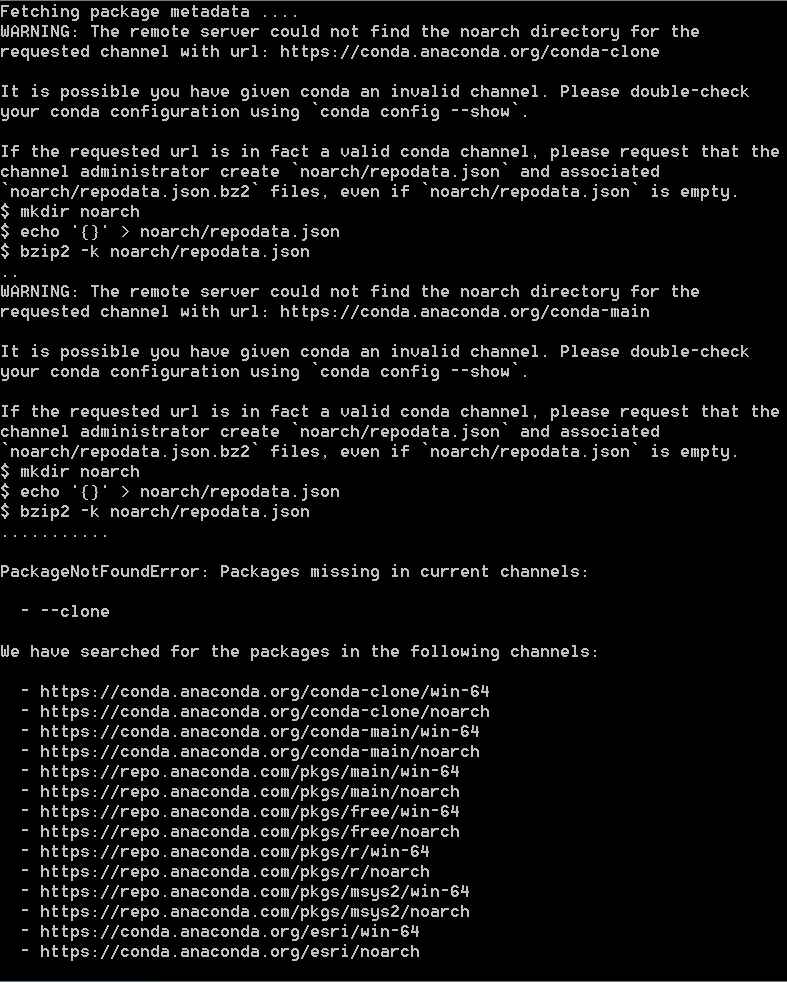

it was failed and the following error is appeared

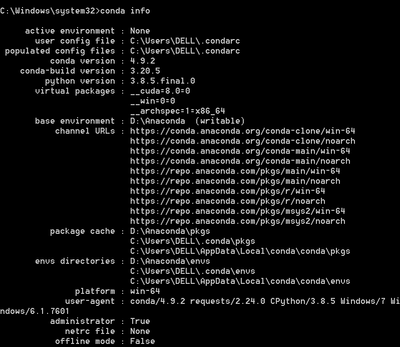

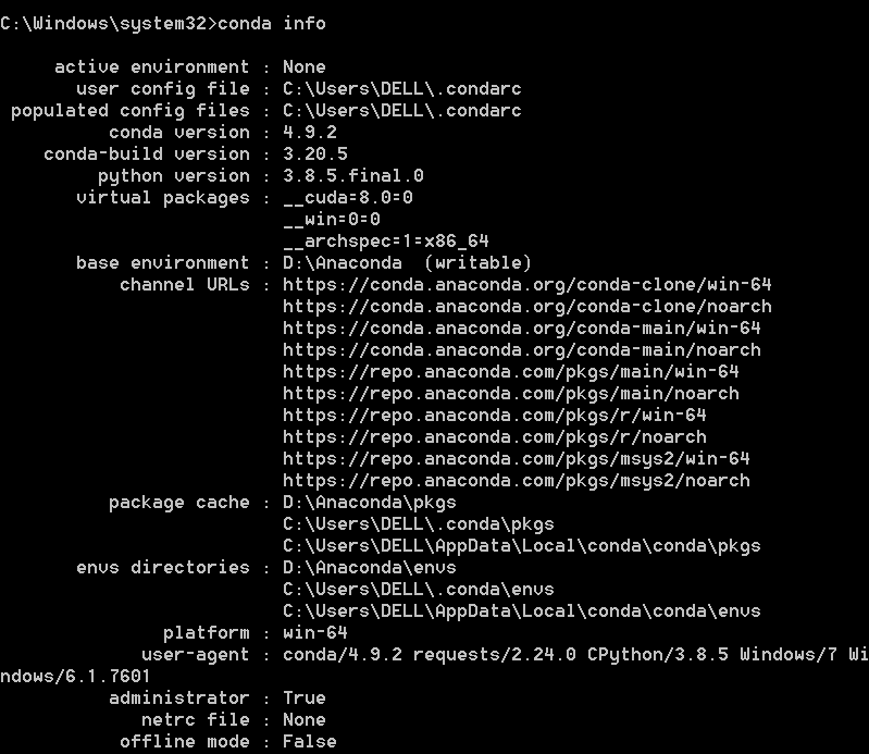

and here is my conda info

i write ''conda create --name deeplearning --clone arcgispro-py3'' to create in my local disc
but it was failed and error as presented in (attached) figure 1 is appeared

arcgis pro doesn't support python 3.8.5
you must have another conda environment.  If you want to use esri's deep learning stuff, get rid of it and install what they provide in the link I posted
