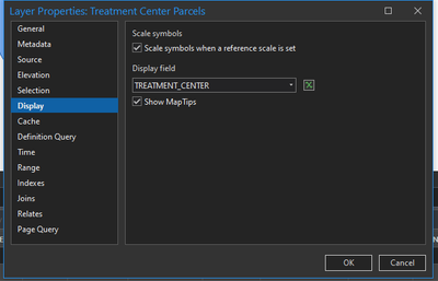

When publishing a map service from ArcGIS Pro 3.0, the resulting published map service has the wrong display field.

Currently on 10.6.1 upgrading to 10.9 very soon. I saved both the mapx and aprx and published with the same results. However, I changed the field name from TREATMENT_CENTER to TREATMENT_NAME and republished and it picked up the TREATMENT_NAME field so this must still be true:
The display expression defaults to the first field of string type that contains the text name (case insensitive) in the field name. If no name field exists, the display field defaults to the first field of string type, then the first field of integer type, then the first field of any type.
