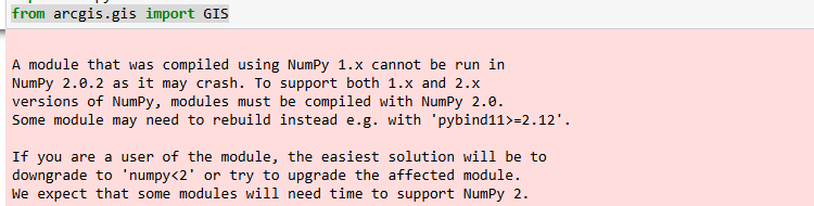

I recently updated to 3.1.7 and started running into this error whenever I try to import packages that are dependent on numpy:

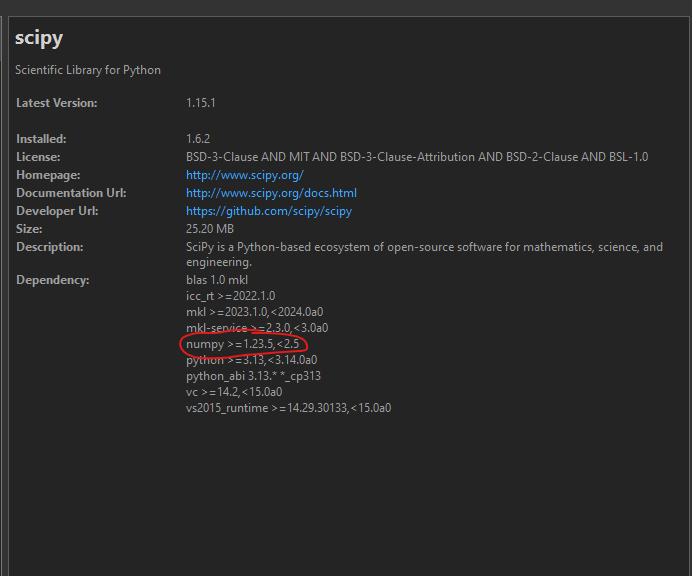

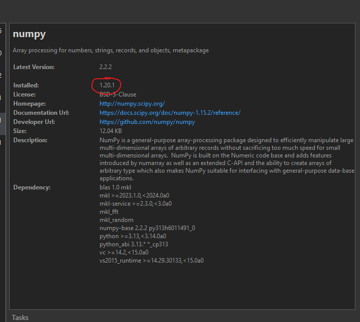

Since the error suggests something is going on with my numpy install, I started looking at some of the package installations in my ArcPro environment and it looks like my numpy installation is incompatible with my scipy installation:
First off, I am confused because my numpy install appears to be below 2.0 but the error says that the module is being run on 2.0.2. I tried to upgrade my numpy package in a cloned environment via "conda install numpy=1.23.5", but the install fails because my requested specs conflict with pinned specs:

When I look at the codna-meta pinned specs it's got numpy 1.20.*
I also asked my co-worker about his environment and he has the same numpy and scipy versions but, scipy lists the numpy dependency as numpy>=1.19,<1.26.0.
Why does the same scipy version have different numpy dependencies? And how I can I resolve this dependency conflict if scipy lists a numpy dependency version that is incompatible with my pinned specs?
