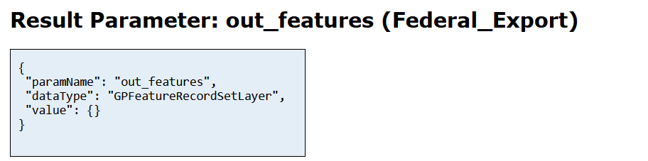

I am trying to successfully return a feature layer as the output of the GP service and having absolutely no luck.
I have a very simple python toolbox tool with the following output parameter:

I'm able to execute the tool successfully and publish the results to a standalone ArcGIS Server.
When I submit the job, the logs say that everything was executed successfully and the feature class in scratch.gdb in the related arcgisjobs folder looks correct on the server.
However, when I try and view the contents of the output either using the REST endpoint by submitting a job using Javascript, it is always empty.
Somehow, I'm not setting up the output parameter correctly but I can't figure out the trick.

JillianStanford
In case it's helpful to someone else, changing the output parameter type to "DEFeatureClass" did the trick.

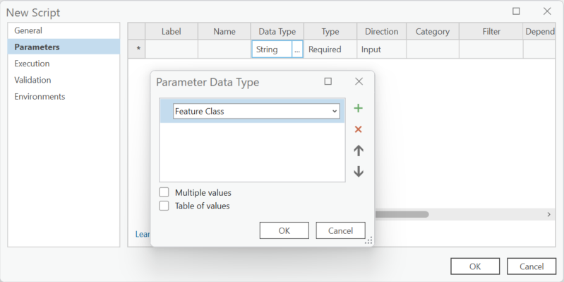

PrayagShah
Hi Jillian,
I am having the same issue that unable to see the output through javascript but on standalone it works perfectly.
I am trying to set up the Parameters through ArcGIS Pro and I do not see the option named DEFeatureClass. Do you know what name would be similar to DE Feature class?
Thank you for your time.
JillianStanford
Hi,
I think it would just be a feature class - Parameter data types in a Python toolbox
