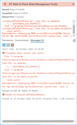

I want to convert a table with an X and Y couple who is hosted in a database, but when i try to use the "Display XY Data" tool, i have this error :
What does it means ?

Could a special character in the column name throw the SQL error??
I saw that degree marker in there. A cold chill ran down my spine. (Then I realized my windows is open.)
Try a file with safer column names.

The connection to your database is failing.
First try writing to a shapefile instead of a geodatabase to test the tool then fix your database connection.
You have the ODBC 18 driver installed. If you are using ArcMap that will fail. It won't work with ODBC version > 17.

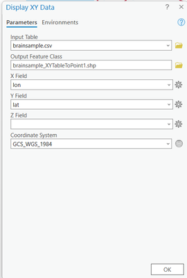

My first thought was that you specified the Output Feature Class wrong. I still suggest you write to a shapefile to test it but I also see another message about "empty_out_bounds" and the error suggests a typo in one of your "field" parameters. Can you take a screenshot of the dialog and post it here? Like this....
In my simple CSV file test it was able to find the column names on its own, no chance for me to type it wrong.

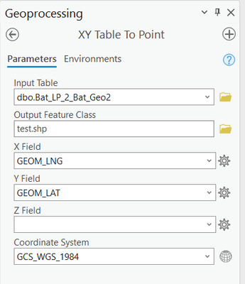

JasonBOCQUET
Hi, for the screenshot you ask :
I test with ".shp" in the name on the Output Feature Class, but it change nothing.
Here the error message :

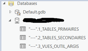

Hi @JasonBOCQUET - yes, this is the preferred way to connect to an enterprise geodatabase and then creating a *.sde connection file in ArcGIS Pro to see your data.  When you create the *.sde connection file for your eGDB, do you see feature classes, feature datasets and/or more?  Based upon the GP error message, it does seem there is a connection problem.  This tech support article/workflow may assist.
JasonBOCQUET
I see only table in my SQL database because we host only table with X/Y column in our database.
That's why I have to use the "Display X/Y data" tools.
