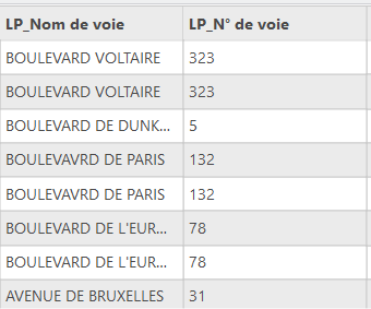

I have this term in my header column some times :

Could a special character in the column name throw the SQL error??
I saw that degree marker in there. A cold chill ran down my spine. (Then I realized my windows is open.)
Try a file with safer column names.
JasonBOCQUET
The error was very stupid.
The space between the name of some columns made the error. I removed the spaces and the "°" and it works fine
