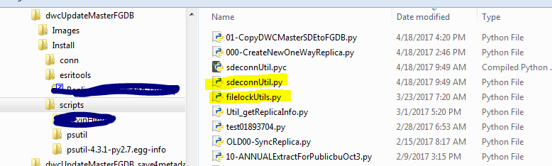

I'm trying to test some of my custom tools, written for a ArcCatalog python addin.   This is my first attempt to use Pro, without the convenience and the power we have with ArcCatalog (but hoping the idea: Add Stand Alone Data Catalog Like ArcCatalog to ArcGIS Pro  will still happen so that this isn't as critical a test ....please vote up the idea! ).
I have several blahUtils.py  type scripts to separate/organize my common functions. These are located in my Scripts folder in my addin file structure and I import into my tools/scripts using
from blahUtils import *
from moreBlahUtils import *
# etc...
rather than in a library in the python folder....that is, keep the addin all together.
This structure works well in ArcCatalog running is as an built/installed addin or from the Toolbox/Tool used to create the addin.
Putting aside the differences between Python 2.x and 3.x for the time being, how would I import the utility python scripts within my main tool script?  I have read thru
