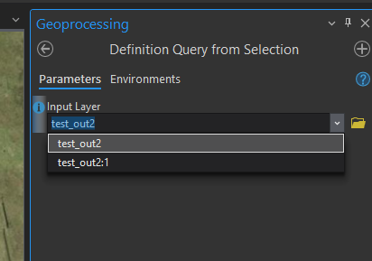

  2. Second question - Is there a way to identify the specific selected layer, besides using the name of the layer? I'd like to have the tool work on a selected layer even when more than on layer has the same name. Is there a property that indicates the order of the layer? If so, I haven't found it.
    • In the input drop-down, ArcPro adds ':#' when more than one layer has the same name. Is it possible to access this index?
