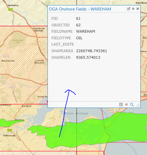

I have 2 features (both from a different layer) overlapping each other on my map. They are both turned on and visible.
However, when I use the hand/identify tool to click on a shape, the resulting pop-up only provides me info about the top feature. There is no option (like in the WebApp) to scroll through to view the attributes of the feature underneath.
I struggle to believe this basic feature isn't implemented somehow. Can someone guide me? Thanks
clicking on the green polygon, I can't view attribute information for the hatched red polygon underneath.

Hi Theodore,
Click the drop down under the Explore and you can select 'Visible Layers':
You will then see an option at the bottom to select the layer you want to identify in the pop-up:

Excellent, thank you.
