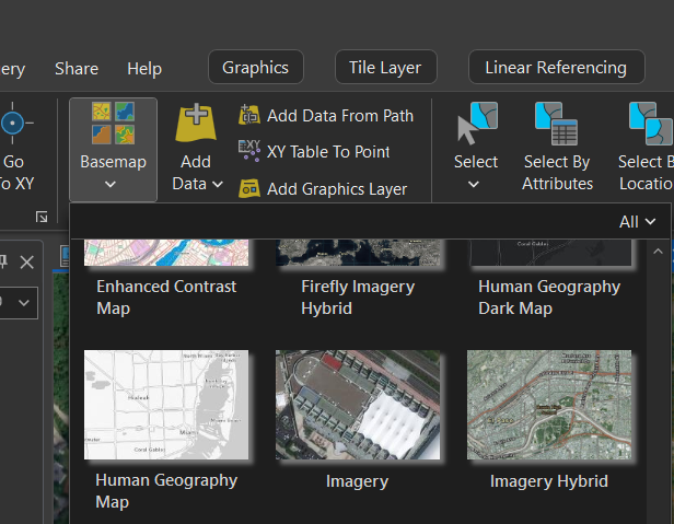

Very belated answer - I was having the same issue in Pro 3.4. I had to reload the Imagery (under Basemap) and that fixed the problem! I can only assume the link I was initially using for ESRI's World Imagery was an older one that lacked functionality.

  1. Instead of just changing the basemap, I will add the tile layers directly from the Living Atlas (Add data, Living Atlas, filter by Status = Authoritative, search the name of the Basemap). This works in both ArcGIS Pro and ArcGIS Online, and the pop-ups come up immediately with the metadata of the basemap you're using, including the source date and sourcenames. For something like the NAIP basemap, that has a separate metadata layer you can also add from the Living Atlas. Using this in ArcGIS Online (as opposed to Pro) will also highlight the entire tile so you can see the extent of the tile you clicked.
