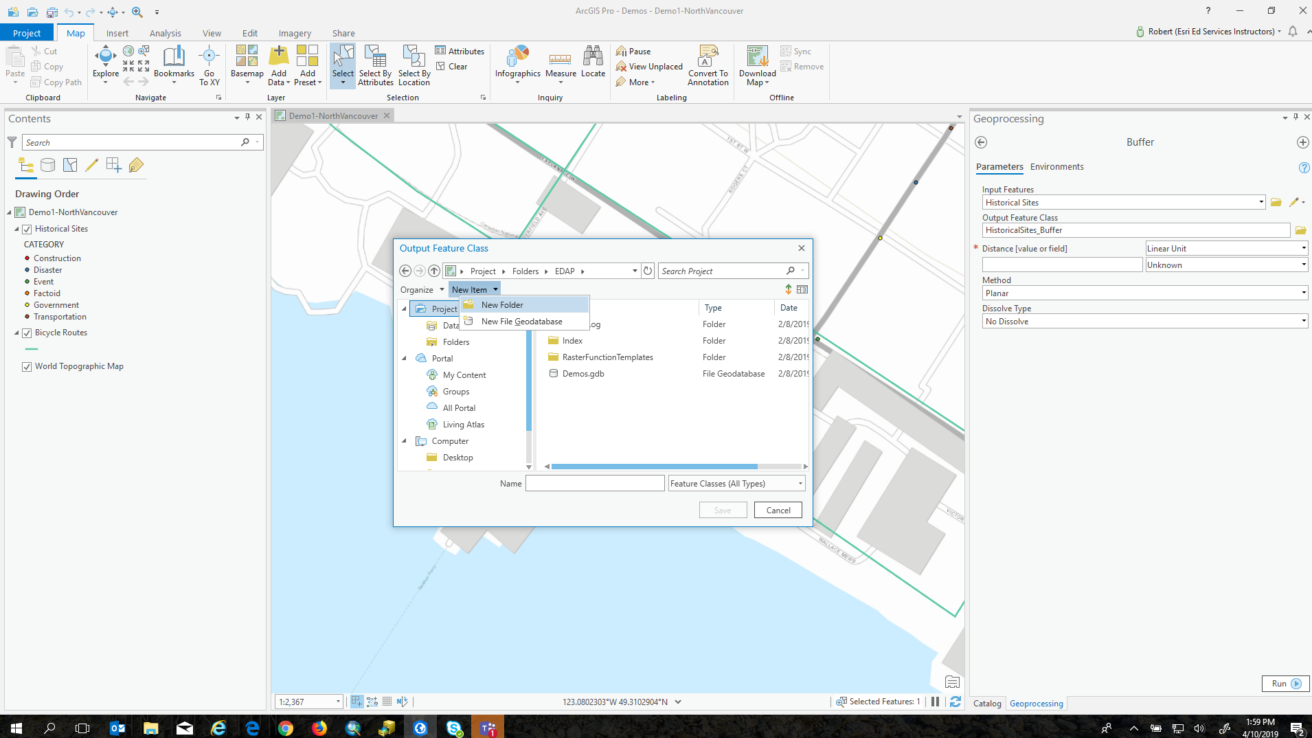

With regards to new folders, this is specifically when navigating folders, via any geoprocessing "Select output path" interface.  In a perfect world I would create the folder before opening a tool, but I tend to forget as I always opened the tool, then created the folder for the past 15 years

Hi Luke - using AGP 2.3.2 , for Geoprocessing parameters such as "Select output path" or "Output Feature Class", the User Interface to select the output gdb location/feature class name does have a "New Item" dropdown where you can create a New Folder or New File Geodatabase while completing the tool parameters.  Hope this helps!
