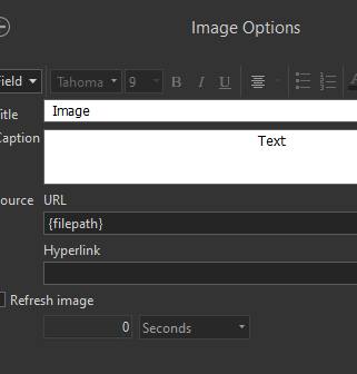

And don't forget that you can use the "Image" type in the popup configuration to display the file as well.
Great for local access to images and files that for whatever reason, can't be included in the GDB itself (though attachments are really nice).
One caveat: this only works for desktop GIS. "file:///" links do not translate to web maps.

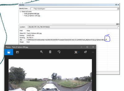

I have got the hyperlink to work in ArcMap without changing anything as you can see below. My problem now is just Pro! Why would it work in one and not the other? Is it just not designed to work in Pro?
I have thousands of data to go through so would rather not have to go through each point and manually put the hyperlink in. Is there a button I can just press which will make my content in these rows hyperlinked?
