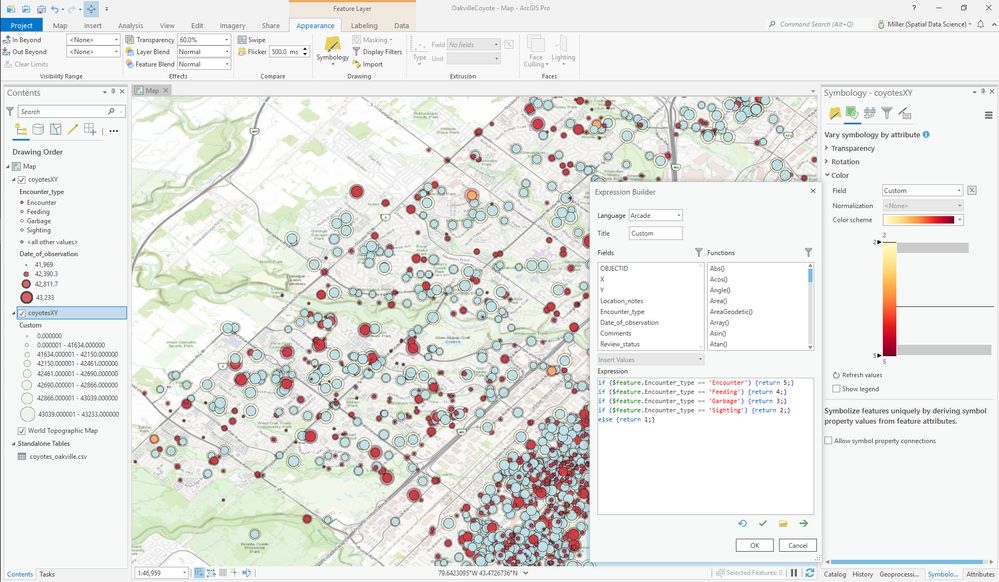

MillerWang
It certainly could be done with Arcade expression, which is almost the same as any code language. Here is one of my example. Cheers!
