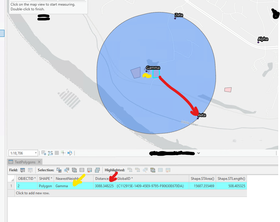

I am trying to use attribute rules to write in the distance to a nearest neighbor, I've been able to get the nearest neighbors name to show up, however the distance alludes me.  Here is the code I was using, however when add an area it seems to pick up the 3rd closest neighbor and not the nearest, can anyone help me figure out what I am doing wrong.
var NeighborLayer = FeatureSetByName($datastore, "TestNeighbors", ["NAME"]);
var searchDistance = 10000;
var NeighborIntersect = Intersects(NeighborLayer, Buffer($feature, searchDistance, "feet"));
var cnt = Count(NeighborIntersect);
var minDistance = 10000;
var name = Null
if (cnt > 0) {
    for (var Neighbor in NeighborIntersect) {
        var dist = Distance(Neighbor, $feature, "feet");
} else {
    // pass no features found within search distance, name remains null
return dist;

After line 10, you have to check is dist < minDistance. If yes, update minDistance and name. At the end, return minDistance.

phess_luckstone
This is awesome and it works on the database side when I bring in those layers directly into Pro from our SDE.  However when I tried to use that with a published service it didn't work, any ideas why, is it because it updates both fields at once?  When I tried to publish with this attribute rule turned on it wouldn't even let me publish but after deleting the attribute rule it let me.

Thank you for your reply, I believe that services can't handle array's  and using what you had mentioned earlier this code works in our service perfectly, thank you for your help!
