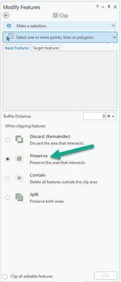

@SanchezNuñez can you also try the 'Preserve' method for Clip tool?
