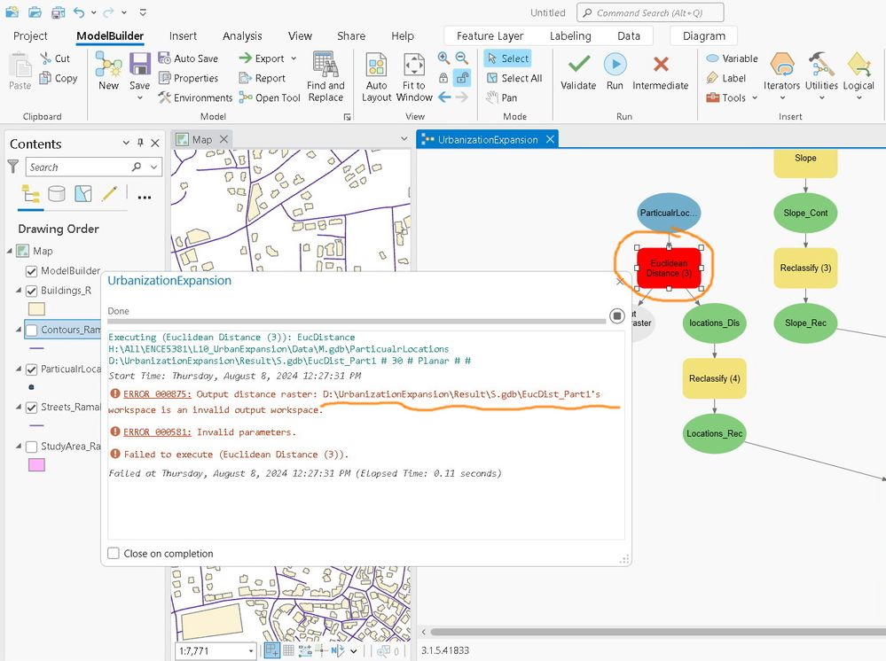

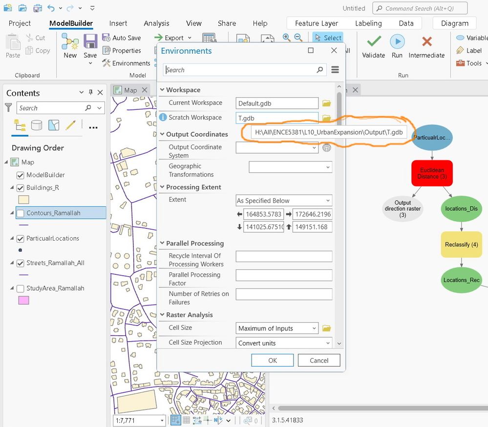

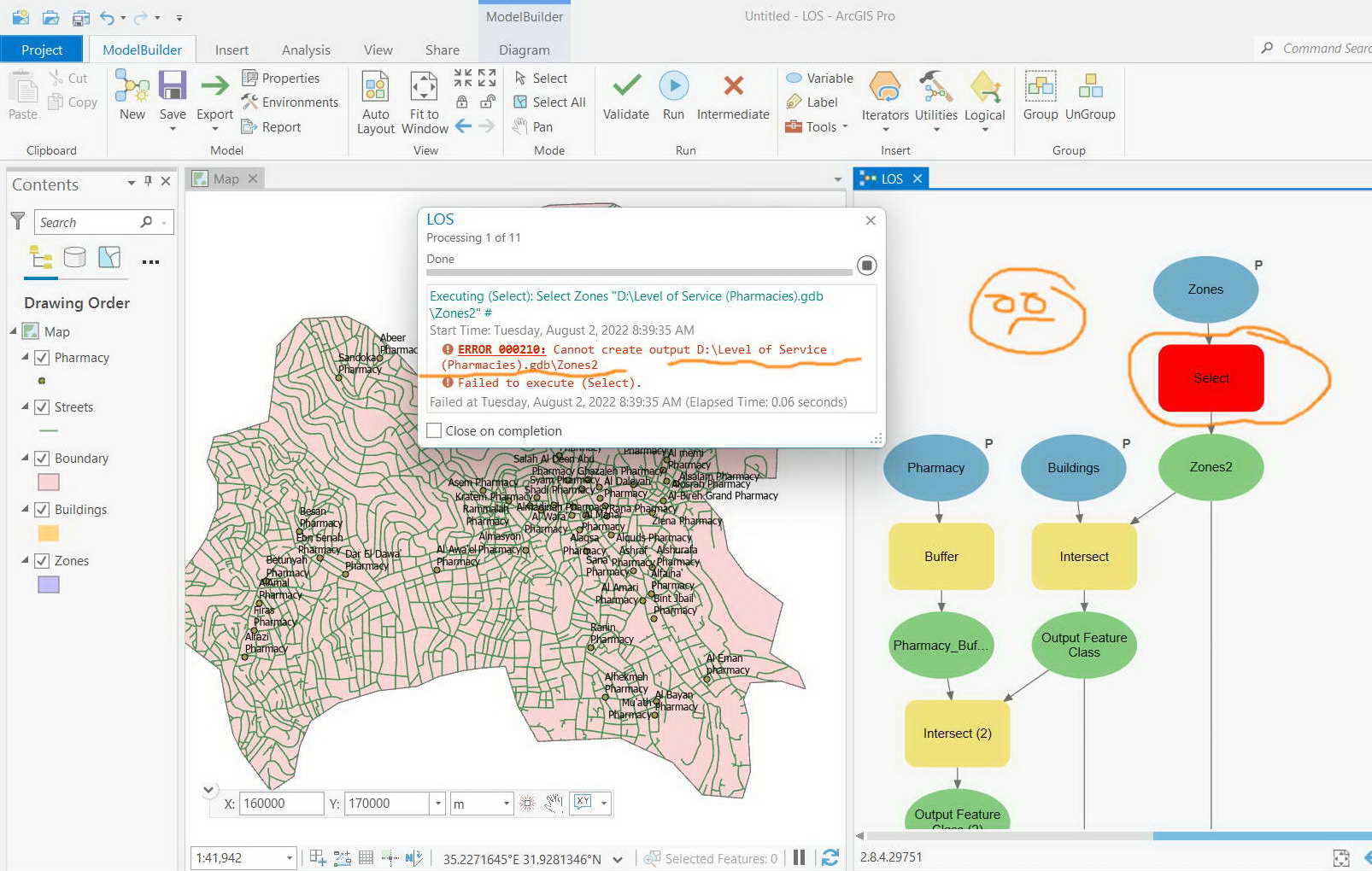

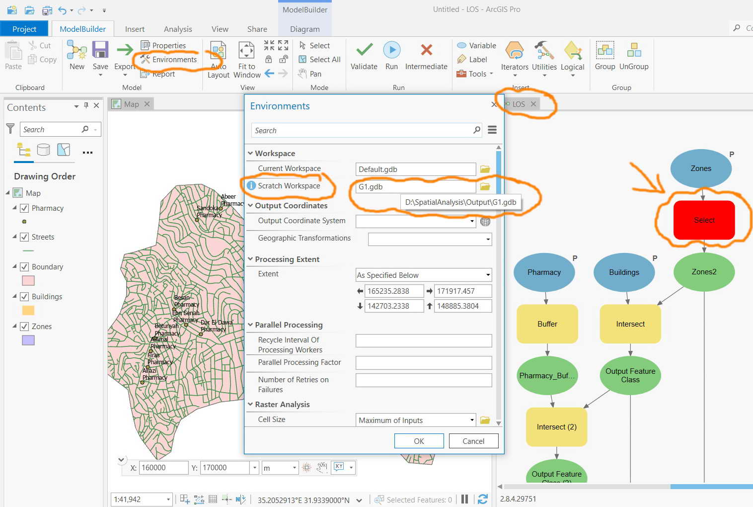

Despite the fact that the scratch workspace environment is set properly, the marked tool in the screenshot below fails to respect this scratch workspace and ends up with an error. The “validate” tool is performed with no luck to resolve the issue
What could be the issue here?

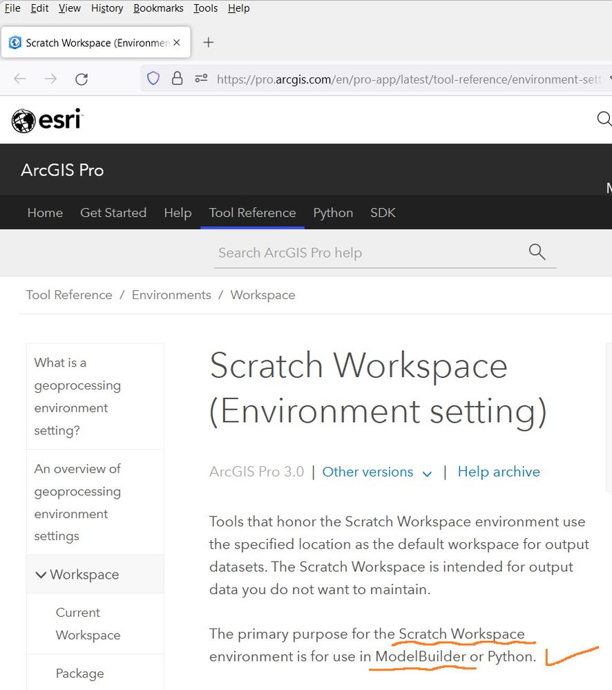

the scratch workspace and the scratch folder are not supported environment parameters in a model or via python
Scratch Workspace (Environment setting)—ArcGIS Pro | Documentation
... sort of retired...

Not all tools support all environments.  Check the bottom of the link I posted for the "Select" tool
