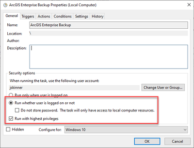

Hi @Savannah2019 ,
Did you set up the model to run as documented here?
If so, you can open Windows Task Scheduler on the server, right-click the scheduled model > Properties and set to execute the task whether the user is logged in or not:

Hi @Savannah2019 ,
