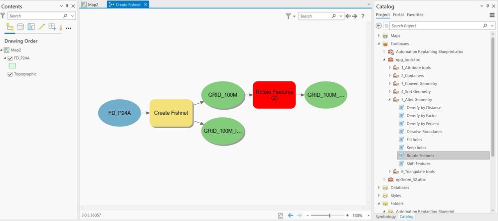

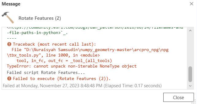

raisya_samsudin
Hi Don,
I tried to import your Alter Geometry - Rotate Features into my model builder to rotate my grid but, I got this error.
