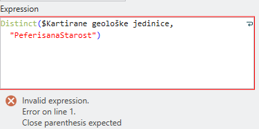

THANK YOU for HELP! in both cases receive these messages (see screenshot below).

What are you trying to do with this code? This affects what profile variables and functions you're able to use in your code. For example, labeling and visualization gives you a very limited set of profile variables and function bundles for efficiency reasons, whereas field calculations and popups give you more.
In any case, you can't use "$Kartirane geoloske jedinice", since that is not a FeatureSet variable.

THANK YOU VERY MUCH! In the first question I explained that I want to return unique values ​​from a field/column of the fgdB table that participates in a 1:M relationship, so that I can create a report. "$Kartirane geoloske jedinice"("$Mapped geological units") is an alias of FC/layer name, and ''Peferisana starost''(''Preferred age'') is the name (alias) of the field/column from which I need to return unique values.

You're using the layer name instead of "$layer"
