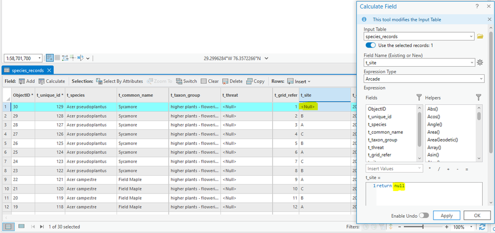

For what it's worth, I was able to set a value to null using Arcade in the field calculator in ArcGIS Pro 3.2.2 (mobile and file geodatabases):
return null
It worked for setting the shape field to null as well (mobile and file geodatabases).
