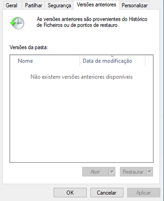

@Robert_LeClairand @BarryNorthey   It is in OneDrive.
When I tried to restore from Windows Explore, there were no versions:
Robert_LeClair
Esri Esteemed Contributor
Sadly, I think the file geodatabase is lost based upon your screen grab.

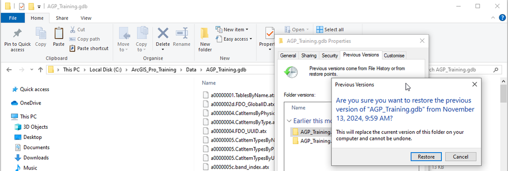

BarryNorthey
Depending on your PC setup and where the fGDB is stored you can consider the following. This example assumes the fGDB of interest is on your hard disk. I am working on my home PC with full admin rights.
Warning: I haven’t tested this but it seems to be straightforward.
First --> backup anything you can’t afford to lose (overwrite).
  • Set focus to the fGDB folder in File Explorer. fGDBs appear as folders in File Explorer.
  • Click Properties in the Open group on the ribbon.
  • Click the Previous Version tab.
  • Click Restore. You will have a final chance to Cancel or Restore.
This should restore the version to the date indicated.
