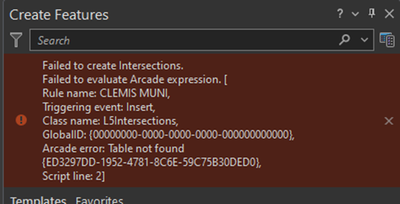

After upgrading to Pro 3.4 our attribute rules using the $datastore throw a 'Table not found' or a 'Layer not found' error.  We're on AGE 11.1 and using branch versioning.
The error shows what looks like a GUID instead of the layer name.

Same here! It's only erroring out on one arcade expression even though everything looks fine. The table exists etc. and we use this same expression format for other rules that aren't erroring out.
Did you find a solution? I'm about to put in a ticket.

I ended up creating a ticket.
  1. Bug Number: BUG-000172275
  2. Synopsis: Arcade Error: Table not found error when editing referenced feature services that use FeatureSetByName with the $datastore variable in ArcGIS Pro 3.4
