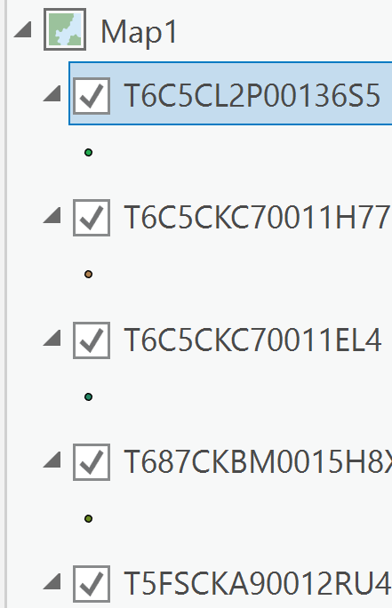

Davec43
Here's a snippet of a portion of the output. Since the layer starts with a number, arc adds a "T". I'm trying to script removal of all the "T's" since it can be tedious manually removing all of them.

RichlandGIS
lyr is a Layer class, need to grab the layer name from it as string.  Think this is what you are looking for:
for lyr in layer:
    string = lyr.name[1:]
Though, you will still get an error if you try to save them with a name starting with a number in a geodatabase.

Davec43
I see what you're saying. I found this from stack exchange and it'll strip the first character from Layer names if they don't have a number as their second character.
fcs = arcpy.ListFeatureClasses()
for fc in fcs:
    Arcpy.Rename_management(fc,fc[1:])
When I try it with a T123... I get
ERROR 000354: The name contains invalid characters
Failed to execute (Rename).
I'm assuming there isn't going to be a way around this?
RichlandGIS
Unless you want to export them to shapefiles (which do allow filenames to start with numbers) you will run into that error.
You could use something like:
string = '_' + lyr.name[1:]
which would replace the 't' with and underscore which will allow you to save them in geodatabase.
R_
Davec43
Thats how I'll have to do it. Thanks!
